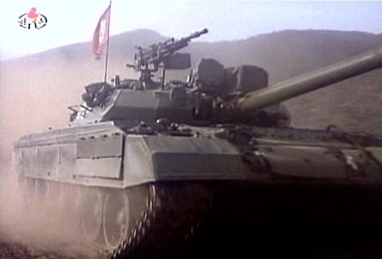

"The new tank appeared to have better mobility, survivability and firepower than the existing Chonma-Ho (Pegasus), apparently,"
According to a recent analysis published by Seoul's Defense Agency for Technology and Quality, an affiliate of the Defense Acquisition Program Administration, the Pokpung-Ho is believed to be armed with either a newly developed 125mm or 115mm main gun.
The improved version would be mounted with a 14.5mm KPV anti-aircraft machine gun, which is more powerful than the 12.7mm gun on older tanks, the analysis states.
Other improvements for the Pokpung-Ho include a laser rangefinder, an infrared searchlight and an up-to-date fire control system, according to the publication.
The North Korean Army is believed to have about 3,900 tanks, and only one elite mechanized unit would operate Pokpung-Hos.
14.5mm se cebaron con la antiaérea :lol:
en un carro occidental no pasa de 7,62 en uno oriental suelen ser de 12,7
14,5 para dejar sorda a la tripulación de cualquier apc
hay historias de iraq 2003 cuando algunos apc eran atacados desde ametralladoras 12,7 que tenían algunos tanques inutilizados o escondidos. relataba el tipo que los impacto castigaban duramente el apc y llegaron a preguntarse si resistiría mas castigo de una o 2 ametralladoras 12,7
bueno si llevamos esto a 14,5X114 con munición AP
un apc normal no resistiría mucho

Como el asunto es un poco complicado,aqui va una recopilacion de las ultimas imagenes del MBT norcoreano (M-2002/Pokpoong) y que por lo observado,seria un desarrollo a partir de los T-62/Ch'onma-ho.
Aqui van las primeras imagenes que aparecieron a princios de 2010,donde se aprecia bastante bien dicho MBT.
http://1.bp.blogspot.com/_9xAtiwSh0MI/S_JXxYCDzpI/AAAAAAAAA2I/B_7JLgkHGGQ/s1600/tank6x.jpg
http://4.bp.blogspot.com/_9xAtiwSh0MI/S_JXxOtTisI/AAAAAAAAA2A/L-CSvxDlqaQ/s1600/tank2d.jpg
http://2.bp.blogspot.com/_9xAtiwSh0MI/S_JXw0vqpWI/AAAAAAAAA14/vrhGIpI7PlI/s1600/tank3b.jpg
http://1.bp.blogspot.com/_9xAtiwSh0MI/S_JXwTaDDlI/AAAAAAAAA1w/FBi3bOTh26U/s1600/tank4s.jpg
http://2.bp.blogspot.com/_9xAtiwSh0MI/S_JXwAfh0kI/AAAAAAAAA1o/W-gHhC0Xgv4/s1600/tank5h.jpg
A partir de aqui ya entrariamos en una nebulosa de confusion a tenor en cuenta de las siguientes imagenes publicadas durante la Parada Militar de Octubre de 2010.
http://img190.enlaceno.us/img190/6462/n2125438721.jpg
http://1.bp.blogspot.com/_9xAtiwSh0MI/TLR41oukaQI/AAAAAAAABJw/nf95ZOheXck/s1600/northkoreantankcrewsw021.jpg
http://seipankoji.cocolog-nifty.com/photos/uncategorized/2010/10/12/m20101northkoreaoct2010.jpg
http://seipankoji.cocolog-nifty.com/photos/uncategorized/2010/10/12/chonmaupgradeoct20104_3.jpg
http://img87.enlaceno.us/img87/9337/pokpoongnorthkoreaoct20.jpg
Si observamos dichas imagenes nos encontramos,por una parte diferentes configuraciones de torre y blindaje (notese a la forma de ese 'BDD') en diversas barcazas.Se puede apreciar las que corresponden a los T-62 originales o a las nuevas 'alargadas',con la posicion del conductor en el centro o en la izquierda (recordando configuraciones propias del T-55/ T-62) segun el tipo.
Todo esto me lleva a pensar a que lo que han venido enseñando,pudiera corresponder a una amalgama de modernizaciones del Ch'onma-ho,modelos de desarrollo/evaluacion,prototipos o lotes iniciales/basicos,mas que la variante definitiva del M-2002 (version mas cercana quiza a las de las primeras imagenes?).
Mas alla del clasico juego al despiste al que estan acostumbrados los norcoreanos,dejo a los compañeros que lo valoren :wink:
