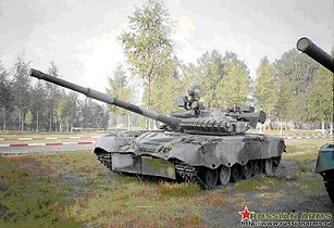

Tanque T-80
   T-80BV
(www.rusiansarms.ru)
